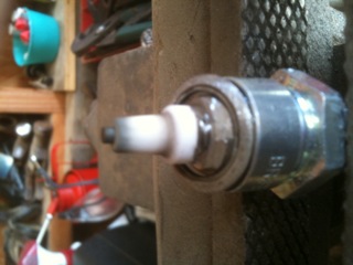

  3. I did the plug chop before and after I changed the reeds. But I notice a bog now that I did not have before it seems to not want to rev as quick so I guess something is rich it sounds fine as long as you just rev it but when you put it under a load you can tell. I checked the pilot it doesn't seem lean I have the needle on the next to leanest clip and I notice the main is a good bit richer so I guess thats what it is...

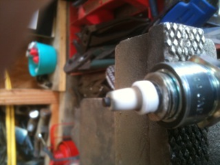

  4. Thanks for the reply I did the plug chop just as you and everyone has described. The one on the right is after I installed the vf3 reeds and it seems to be alot richer on the main jet but somehow I lost color on the tip of the plug. That is were I get confused bc if it is richer shouldn't the top be colored more than the first one..
  5. Anything is better than nothing. I'm just confused as to why the first one has the brown at the top and the second one does not.. Am I lean in the needle? Should it even be brown on the top from one wot pass. I am pretty sure the second one is pretty rich on the main. Any advice would be great thanks....

  8. Little confused here I did a plug chop with stock reeds and then switched to vf3 reeds. The vf3 made my main jet richer but it seemed to lean my middle if I'm reading the plug right that is the top part of the porclin on the plug. As you can see The one with the stock reeds is alittle black on top of the plug and lighter at the bottom for the main jet.. The vf3 is darker and thicker at the bottom for the main jet and does not leave much on the top of the porclin is it just alot richer and washing it out or is it lean on the bottom and rich up top. It does have a little bog bc it made it a good bit richer. My main right now it 340 clip postion is one postion leaner. Any help would be great as I did not imagine it would change my jetting this much...
