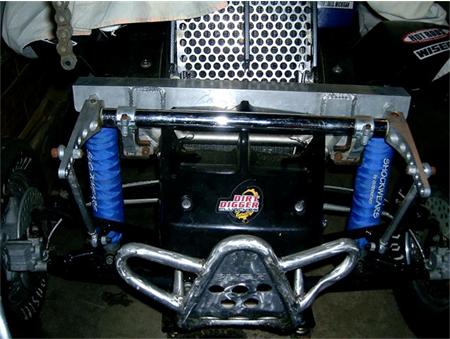

r_flagel222 Posted May 20, 2008 Report Posted May 20, 2008 (edited) check out this pic mabe give you an idea .... i made this, its with stock shocks..... just forget the sway bar and think about the H shape aluminum bar you see Edited May 20, 2008 by r_flagel222 Quote
