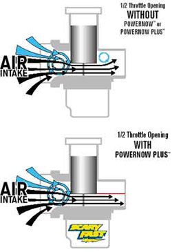

04' Black Betty Posted February 26, 2007 Report Posted February 26, 2007 Just wondering if anybody runs these on there shee. My discription of mine says I run them but after thinking awhile i thought I would get some input before I paid the $200 for them, let me know. Anything would be appreciated. Quote

woodro77 Posted February 26, 2007 Report Posted February 26, 2007 they are not like the boost bottle . the scary fast power now do work , i have never tried them on a banshee but i have put one on a 4 stroke and i did notice alot better throttle responce. is it worth the price ? thats up to you , to me it was . every little bit of power is worth it . people shouldnt knock a product unless they have tried it first . Quote
FireHead Posted February 26, 2007 Report Posted February 26, 2007 they are not like the boost bottle . the scary fast power now do work , i have never tried them on a banshee but i have put one on a 4 stroke and i did notice alot better throttle responce. is it worth the price ? thats up to you , to me it was . every little bit of power is worth it . people shouldnt knock a product unless they have tried it first . If you can explain the principles for how a product like this improves a properly functioning intake tract, then I am all ears. :thumbsup: Quote
blaster668 Posted February 26, 2007 Report Posted February 26, 2007 If you can explain the principles for how a product like this improves a properly functioning intake tract, then I am all ears. :thumbsup: I do not have personal experience with the power now, but at least in theory it will help. Basically it increases the intake velocity at carb openings below half throttle. It pretty much fools the intake system to act like a smaller carb at partial throttle openings. Therefore, it will aid in throttle response and bottom end...there would be no top end benefits. Kind of similar to how a powervalve works, but not nearly as dramatic because it doesn't affect port timing. There are actually quite a few ways to help intake flow characteristics. One that has shown very positive results is using a honeycomb type tube in the intake tract to make the flow pattern much more laminar. Quote

FireHead Posted February 26, 2007 Report Posted February 26, 2007 WTF are you all talking about? :shrug: those blades you stick in the carb? Yes, the blades you stick in the carb is what we are talking about. IMO is that this product is something that is designed to direct air flow through the carburetor. The trick is, that you shouldn't need to do that if you have a properly designed intake sytem, engine, and exhaust system (which is the case most of the time in stock form). Where this product provides "performance gains" is when you have a poorly designed or malfunctioning intake tract, engine, or exhaust, or you have modified any of those areas to such and extent that they are outside of their operational limits. It's a bandaid product in summary. Past that, by putting a device like that in your intake tract, you could potentially be reducing your engine performance levels. I say this based on the fact that air flowing over a surface at speed creates a boundary layer, which increases in size as speed increases up to the point of the speed of sound at which point the air will not flow any faster. Thus, to exaggerate a bit, the 2mm thick vanes in your intake tract are now 8mm thick conceptually. While they seem to promote this product as operation on a venturi effect, don't really buy it. On that principle, you would be just as well off sticking a cork with a hole in it in your carburetor. Maybe I'm wrong, as it was said here, I certainly do not own one of these gizmos. I am just speaking from experience (which I should have said earlier), but like I said, if somebody were to explain to me how it actually benefitted a properly tuned and functioning engine, I'd but it. :thumbsup: Quote
04' Black Betty Posted February 27, 2007 Author Report Posted February 27, 2007 Yes, the blades you stick in the carb is what we are talking about. IMO is that this product is something that is designed to direct air flow through the carburetor. The trick is, that you shouldn't need to do that if you have a properly designed intake sytem, engine, and exhaust system (which is the case most of the time in stock form). Where this product provides "performance gains" is when you have a poorly designed or malfunctioning intake tract, engine, or exhaust, or you have modified any of those areas to such and extent that they are outside of their operational limits. It's a bandaid product in summary. Past that, by putting a device like that in your intake tract, you could potentially be reducing your engine performance levels. I say this based on the fact that air flowing over a surface at speed creates a boundary layer, which increases in size as speed increases up to the point of the speed of sound at which point the air will not flow any faster. Thus, to exaggerate a bit, the 2mm thick vanes in your intake tract are now 8mm thick conceptually. While they seem to promote this product as operation on a venturi effect, don't really buy it. On that principle, you would be just as well off sticking a cork with a hole in it in your carburetor. Maybe I'm wrong, as it was said here, I certainly do not own one of these gizmos. I am just speaking from experience (which I should have said earlier), but like I said, if somebody were to explain to me how it actually benefitted a properly tuned and functioning engine, I'd but it. :thumbsup: Hey thanks guys didnt me to stir stuff up but, For $200 you could get alot of for sure upgrades that are proven performance gainers. thanks for all the input again. Quote
