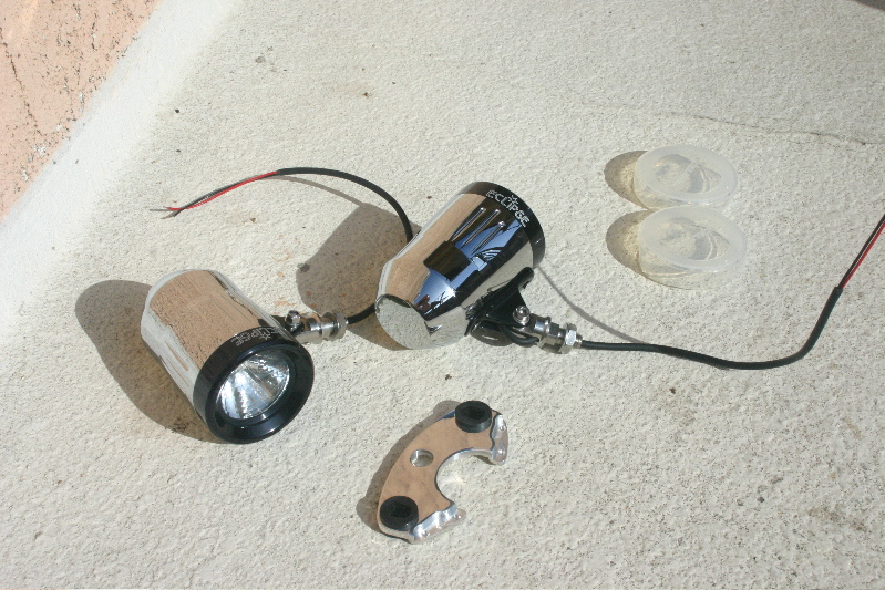

Wallrat Posted November 14, 2005 Author Report Posted November 14, 2005 (edited) Mine just came today and I thought I'd write up some initial impressions on the quality, packaging, size specs, etc. I won't be able to install them until at least tomorrow evening so hopefully I'll have a better review on Wednesday. FYI I am currently running 35w Torchlights on a handlebar mount configuration. The Eclipse's will bolt directly to the torchlight mounts but you might want to consider some for of isolation from vibration if you don't already have it. Shipping - they arrived very well packaged in about 4 business days. Everything was packed tightly so nothing was going to move around inside and scratch up the aluminum. Contents - 2 Eclipse HID's with 12" wire leads, small bag with assorted lugs and terminals, vibration isolating handlebar mount 'wing' (this is recomended by Trail Tech) and mounting hardware, 2 clear silicone lens covers Quality - What can I say? Top notch. I poured over this set looking for scratches, chips, kinks in the wires, everything. I'm happy to report that both lights were flawless as was the wing! If you see anything in the pictures, its either a reflection or a smudge from my finger while I was positioning these things. The only mark I found was on one of the bolt swivels that you use to adjust the light. The edge had a very small mushed area which looked to be caused by a wrench during assembly. Its underneath the light however and not easily noticeable unless you've got your eye a foot away from it. Once mounted I'm sure I won't be able to see it. Impressions - These things are alot bigger than they seemed at the Sand Sports Super Show. They're really the same size but having them in your hand the first time kinda gives you the impression that these things are gonna blind somebody. I took the picture next to the soda can just to illustrate what kind of size I'm talking about here. For their size and very rugged appearance, they're still quite light. Not having a decent scale handy I couldn't accurately say how light but I would venture that you shouldn't have any problems with them wiggling loose while riding. Especially since they came equiped with stainless allens + nyloc nuts - a nice touch in my opinion. I never understood why some manufacturers put out a quality product and then use cheap hardware. Nice to see that TrailTech used quality parts start to finish. On to the pics: Edited November 14, 2005 by Wallrat Quote
