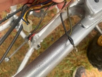

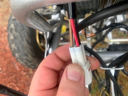

Hey guys my Banshee never had a key with it. I bought an oem keyswitch and needed some help wiring it back to the original harness. I did do some searching and it seems only 2 wires are needed to go to the switch. The red and brown wires are not used on the switch? I have a 4 pin connector which I will be using to reconnect them
Here is what I am dealing with in my harness there are 2 sets of wires that have been soldered together.
-One set of wires is black + red/black stripe
-The other set is black + black/yellow stripe
On the key switch I have red, brown, black, and black/white stripe.
Could anybody tell me what wires I need to connect together?

You sure the black doesnt have a red stripe
<2001
Black on harness goes to B/W on main switch
And R/B on harness to B/R on switch
B/Y should be TORS & not hooked to black ( but i assume thats all disconnected any ways?)
It’s a 1996,
Yes the tors has been disconnected,
I just double checked but the one set on the main harness is a red and black wire soldered to a plain black wire.
