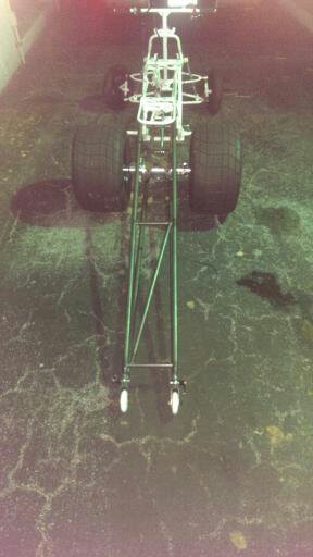

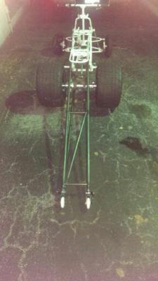

J-Madd Posted December 22, 2013 Report Posted December 22, 2013 There's a look at the 650 cc bike and bar. The orange chassis is for sale btw. $1200. Quote

dragbanshee98 Posted December 27, 2013 Author Report Posted December 27, 2013 i already have the tire to be used for the bar, its off an open wheel on road go kart. ill just have to figure out a way to mount the 3 bolt hub for it. leaning more towards the 4 bar setup now i think, just need to get the tubing for it and start fabbing. not sure about exact 60ft times, our local tracks dont register that time, but the chassis likes to carry the front wheels through second gear and forces me to sit over the tank when launching. Quote
