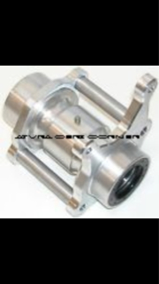

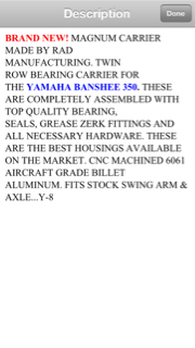

Just bought a billet stock style carrier off of eBay, says it works with stock swingarm, problem is that I have a 3 inch gap between brake caliper brackets and the carrier brackets, is there some sort of spacer kit or bracket kit to make this work? Has anyone else run into this problem
Should have been two aluminum spacers just like the ones between the carrier flanges and longer bolts to Mount the caliper
