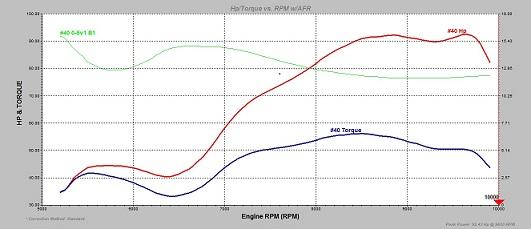

gpr Posted March 12, 2013 Author Report Share Posted March 12, 2013 Here is a dyno from last year when i was messing with it. Don't get too caught up on the hp or torque numbers as it was calibrated wrong and reading extremely low. Regaurdless this is showing the a/f that starts out lean from whicking the throttle open, goes rich, then goes lean again. It is the strangest thing I have ever seen, and has me dumbfounded on how to fix it. Tried probably 6 different needles much smaller in diamerter then the cel's that were running on gas and it didn't help that much. Quote Link to comment Share on other sites More sharing options...
gpr Posted March 12, 2013 Author Report Share Posted March 12, 2013 here is the graph, its pretty small cause of the size limit but you still get the idea. Quote Link to comment Share on other sites More sharing options...

gpr Posted March 12, 2013 Author Report Share Posted March 12, 2013 I had a small bottle of redline alcohol 2 stroke oil i used when i was playing with it. i normally run the redline racing 2 stroke oil, does that stuff work with alcohol? I thought about putting power jets on it, and a vacuum fuel pump just to make sure it would have enough fuel. however on the graph in the higher rpms the a/f ratio was down around 11.5:1 (btw, that is reading on a gas scale, using a gas scale i typically make peak power around 12.7:1), so it had plenty of fuel. I think i would be okay if i could just get that lean spot tuned out. yep, e 85 runs cooler than gas and makes a little more power than gas. It isn't as much as methanol, but I'll give up a few pony's for the other benefits. The odd thing is i had the head off of it, and it didn't look there was detonation. When it closed the plug gaps it must have done it very quickly. I couldn't see any pitting on the head or piston like you typically will with detonation. Plus i couldn't hear it either, and no speckling on the plug.... I believe the plug gap was around 20 thousands. For your car setup are you going to be running efi or a carb? In the efi motors i have been running walbro 340 pumps. they are 255l/hr pumps and have worked well for me so far. I'm still running with stock plastic tanks and lines with no issues what so ever. the e85 will actually clean up the tank and lines and many times plug your fuel filter getting all the old crap out of it, so what for that. It is odd too as the exhaust will look clean instead of black and carboned up. Quote Link to comment Share on other sites More sharing options...

camatv Posted March 12, 2013 Report Share Posted March 12, 2013 the a/f ratio for e85 is differnet than for gas.. i dont know for sure or at what but.. i'd say deff get the dumps drilled, and get pj's in it. maybe even need 2 pj's in to supply enough i dont know on the massive failure of the plugs. only time i have seen that was from a huge lean out.. the deto rattles so hard so quick it shuts the gap. when they are close they deto and shake the plugs out and damage the motor. when i use alky i just watch the plugs. i have never dyno'd an alky bike with sniffers in it. in the past i used EGT's and then tuned with plug color and heat after that. the redline alcohol oil would have been fine. alcohol will do the same thing as far as keeping things clean most times if an alky motor is purged they will look brand new when you take them apart. i'm planning on running a carb. Quote Link to comment Share on other sites More sharing options...
