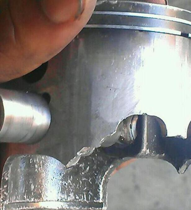

Hello...any info would be appreciated. This is the second time the left side has blew a piston. Even tho its been some months from the first time, I don't think this should be happening. As u can see it looks white and pretty dry. I have dune port from hjr, shaved head, timing plate and t5s. I was running 340 jets in it, kevin said I was running to rich cause my spark plugs were black and wet. So I dropped to a 330. Oh yeah forgot to mention I was having a very bad bog that's what lead me to jetting issue...anyway so I decided to go to a 310 jet and soon as I rode for five minutes, I could hear the piston shatter. Has anyone seen something like this and if so did u figure out what the problem was.?? Thank you

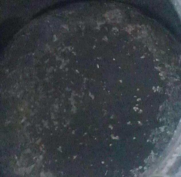

Well I have pics now so here they are..

That's the top of the piston inside the cylinder...looks nothing like the right side. Right side looks nice and brown

Left side a lil whiter than the right. But not by much. In my kn pod filter I do have a slight small whole in the filter where it was rubbing against a screw. Could that lil hole cause it to lean that much of a difference.?? Also should my spark plugs be completely dry..?? Thanks
looks like deto to me, what do you have the timing set at? how much is shaved off the head? what fuel are you running?
Yeah my spark plugs were backing there way out of the cylinders...which I heard or read that was called by detonation. Not really sure what causes that or how to stop it. I'm +4 timing, head milled equal to 21 domes and running 93
Piston Skirt shatter usually means clearance issues. Just had the same thing happen to me.
