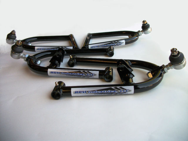

twistingixxers Posted April 15, 2012 Author Report Posted April 15, 2012 That's totally messed up if you guys are goofing with me. and the only reason that I asked is because there is no temp guage no where on the bike...Its ok though. What would be the pros / cons with running a 4 mil banshee engine over a cheetah engine? Hey guys, I bent an a arm, what would you guys recommend for a replacement? Quote
So Cal Suspension Posted April 15, 2012 Report Posted April 15, 2012 That's totally messed up if you guys are goofing with me. and the only reason that I asked is because there is no temp guage no where on the bike...Its ok though. What would be the pros / cons with running a 4 mil banshee engine over a cheetah engine? No, what they are saying is if you run a temp gauge, run it on the TOP hose, not the bottom hose. The top hose is where coolant comes OUT of the engine, so that will be your most accurate temperature reading. Hey guys, I bent an a arm, what would you guys recommend for a replacement? There's some good aftermarket a-arms out there that won't break the bank, or if you have stock a-arms, I'm sure NYUK has one he can sell you. Quote
twistingixxers Posted April 15, 2012 Author Report Posted April 15, 2012 No, what they are saying is if you run a temp gauge, run it on the TOP hose, not the bottom hose. The top hose is where coolant comes OUT of the engine, so that will be your most accurate temperature reading. There's some good aftermarket a-arms out there that won't break the bank, or if you have stock a-arms, I'm sure NYUK has one he can sell you. Oh....Ok Mat..I thought they were joking me again...lol. I was wondering why the bikes didn't come with a temp guage from the factory, just the nature of it I'm guessing. Also I found out yesterday that banshees don't like the slow trail riding for extended periods. After a while of going slow the bike started "popping". There was another banshee rider with us, he stopped everyone one and said to head for the gravel roads so he could open his bike up a little. At first I didn't understand why. But after following him and doing pretty much the same thing he did, the popping stopped. He later told me that banshees operate better in the higher rpm ranges and when riding slow trails can foul the plugs. I was considering RPM Industries A's but have not heard anything of them...Has anyone tried these Quote

twistingixxers Posted April 18, 2012 Author Report Posted April 18, 2012 A few postings up I asked if anyone had tried a arms from RPM Industries. Will someone give me a little insight on them? Quote
