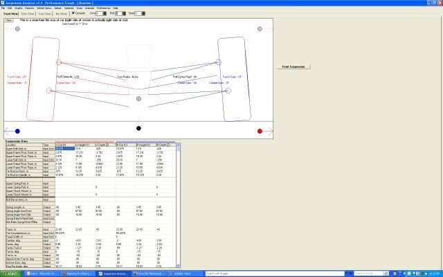

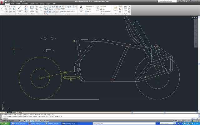

THE358BANSH Posted November 1, 2011 Author Report Posted November 1, 2011 you didnt have a vote to just build an entire chassis. i vote for that. I have finally made up my mind, and that Cam fellow seems to always have something to do with it. After looking at how little of the original Banshee frame I would be using, it is almost pointless not to just build a complete frame. I figure what's the point of a nice cromoly front half when its integrated to a nasty ass mig welded mild steel backhalf. I have all ready modeled the front and rear suspension. Currently everything is at 11" of wheel travel, 7.5" ride height, less than 1/32" of bumpsteer over the entire travel using a YFZ spindle. The frame and steering has been optimized around the YFZ spindle, mainly because it's popular and I own a nice setup now. Anyways, here are a couple pictures to tease everyone before I start a new thread for the entire deal...Evan Quote
