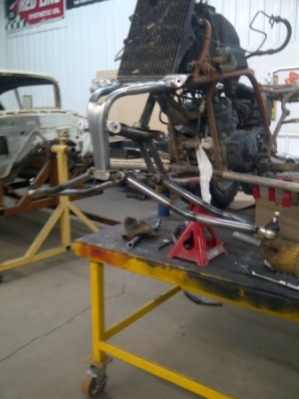

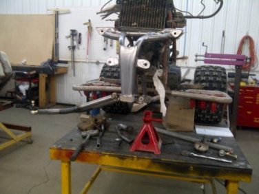

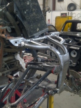

SNT Posted September 18, 2011 Author Report Posted September 18, 2011 started the upper a arm mount and figured out the stearing mount today.. not much too update tho Quote

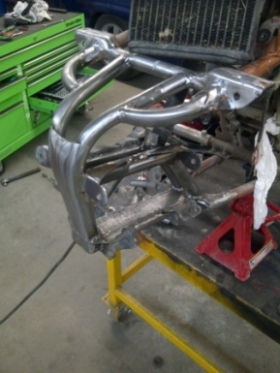

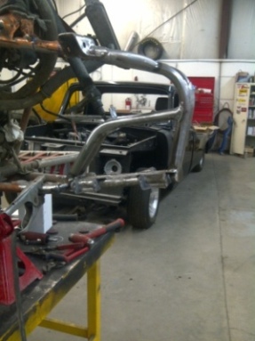

SNT Posted September 19, 2011 Author Report Posted September 19, 2011 finshed upper a arm mounts today Quote

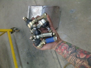

SNT Posted September 19, 2011 Author Report Posted September 19, 2011 starting the a arms next here are the ball joints Quote
SNT Posted September 19, 2011 Author Report Posted September 19, 2011 Thanks man, i kind of dont know what i should do for a-arms, maybe you have some suggestions? I'll be running 450r shocks 18.25 eye to eye. Just because i cant afford long travel shocks at the moment. Quote

SNT Posted September 19, 2011 Author Report Posted September 19, 2011 Decide how long you want them to be. Are you riding woods mostly or MX? A good general width would be 47" wide at the outside of the front tires. If you only ride trails you might want to make it more like 46". Look at 250R long travel a-arms from the different manufacturers and get some ideas. 18.25" is a long shock. I dont know if you want to build a gull wing style arm or straight arms. i want the front width to be 50" tire to tire. i wanna use a gull wing arm.. should i move the upper shock mount into the centure of the quad? Quote

SNT Posted September 19, 2011 Author Report Posted September 19, 2011 hey! MattSCSS you out there? think i should move the shock mounts in? lol Quote

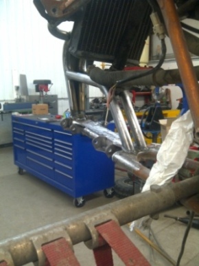

SNT Posted September 20, 2011 Author Report Posted September 20, 2011 na thats ok i think i got it figured but if he sees the thread he should speak up!! lol anyway i started on lower a arms today updates!!! Quote
