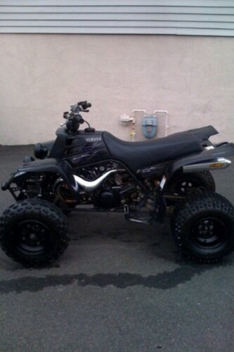

WONDERING WHAT SIZE BORE TO GO WITH WHEN I DO MY REBUILD AND ANY PRODUCTS SHOULD I LOOK IN TO ALSO PLAN ON PUTTING A COOL HEAD WITH 21CC DOMES WITH THE REBUILD KIT AND DELTA 3'S LET ME KNOW WHAT ELSE TO TRY IT HAS FMF'S RIGHT NOW AND BOOST BOTTLE WITH K&N INTAKE OR JUST FILTER. I AM NEW AND OPEN TO ALL ADVICE.

As far as the bore only go as big as you have to.
Timing plate or mod tours would be a good idea.
If you have the money you could get it ported.
Sky is the limit.

stop with the caps....no one likes a yeller on here.
After that......take your cylinders to a reputable powersports shop........tell them your doing a rebuild and you need them bored. They will meausure your cylinder bore and then machine them out to the NEXT appropiate size. you dont just go in and tell them you want it bored .040 over. They will order the next sized up pistons and then they will bore them to the exact tollerences that the pistons require. Also make sure sure that they know how to chamfer the ports to make sure your rings dont snag and rip shit up.
Its WAY easier and cheaper to send them off to a site sponsor on here.......i always used Jeff at F.A.S.T. Racing........but i hear herr jugs racing is good also.
Give one of them a call and have them do the work as you sound a little green at rebuilding bikes....
I recommend only boring to what size it takes to clean up the cyls.. then add cool head, timing plate, and reeds if you can afford it. Give us or any of the site sponsors a call as we can help !
