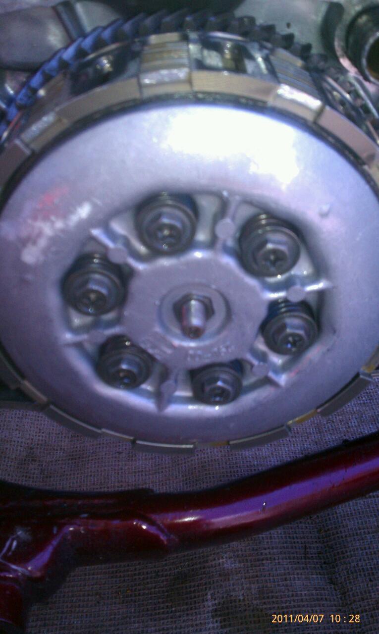

Banshee Rider239 Posted April 7, 2011 Author Report Posted April 7, 2011 use an impact wrench on the clutch bolt it should not keep coming loose and it might have one of those washer that you bend over the nut and the idle i have to cover all marks turn down the idle screw (on the tors or side of carb if tors eliminated) air fuel screw might be lean or rich how many turns is it ? make sure the cable isnt bound up when i took off the clutch case the screw looked like this and when i tryd screwin it in it didnt go much farther it started tighting up .... Quote

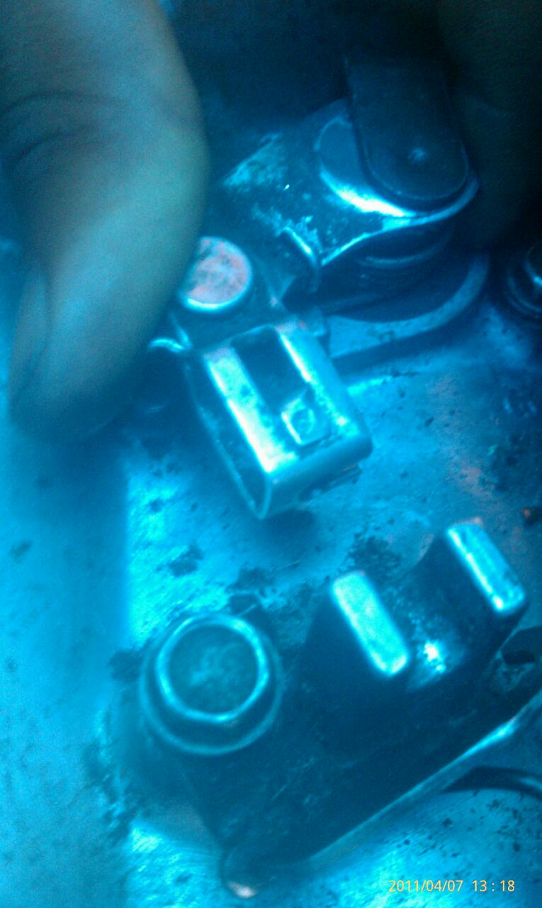

Banshee Rider239 Posted April 7, 2011 Author Report Posted April 7, 2011 disconect your clutch cable off the lever thats coming off your engine.... Line the clutch arm with the point on the cases by screwing in or out that bolt you took a pic off... Put abit of pressure with ur finger on it and line it up... Then adjust your clutch cable according what part are you refering to as the clutch arm Quote

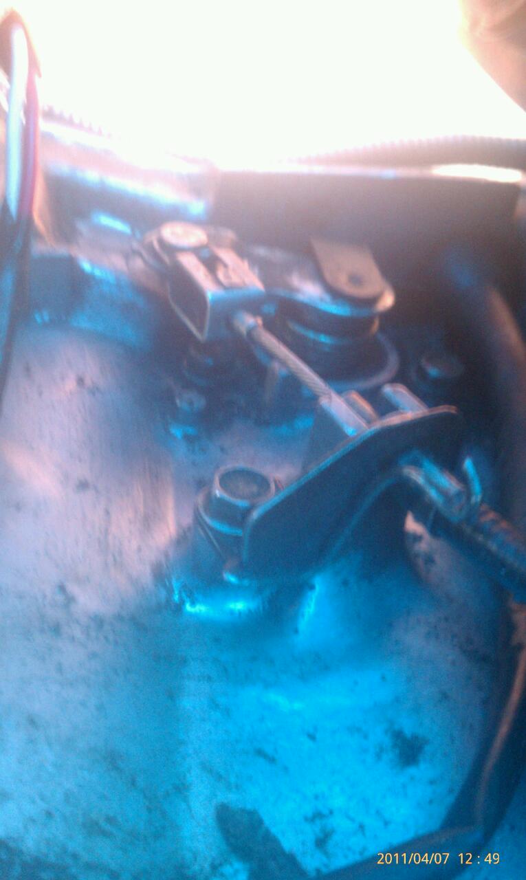

Banshee Rider239 Posted April 7, 2011 Author Report Posted April 7, 2011 Its the lever in that pic that your clutch cable is attached to... take the cable off. Then push the lever toward the middle of the engine with your hand, the point on the lever should line up with the point on the casings... to adjust you use the screw thats in the middle of your clutch... like this? Quote
Larry's Shee Posted April 7, 2011 Report Posted April 7, 2011 Arrow on arm is under your thumb , arrow on case is on hump by sprocket,. Back screw off, hold arm with arrows, snug screw, back off 1/8 - 1/4 turn , hold screw with screwdriver , tighten nut. By snug, finger tite/barely touching. Quote
Banshee Rider239 Posted April 7, 2011 Author Report Posted April 7, 2011 Arrow on arm is under your thumb , arrow on case is on hump by sprocket,. Back screw off, hold arm with arrows, snug screw, back off 1/8 - 1/4 turn , hold screw with screwdriver , tighten nut. By snug, finger tite/barely touching. ok thanks its all good lined up right Quote
