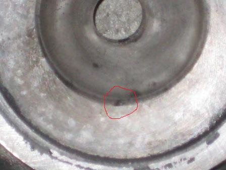

xcentric5 Posted November 16, 2009 Author Report Posted November 16, 2009 My jet sizes are 340 for the mains and 30 for the pilots with the 2nd notch on the needle. No cracks on the intake and everything was tight when i was taking it off. Yea im really kicking myself for not doin a leak test before i took it all apart. If the dome piece is chipped and a little dented is not usable anymore? If not then i have to replace the head too. What is the best head/ dome pieces to use with 65mm wiseco pistons and a 4mil vito's crank? Quote

AKheathen Posted November 16, 2009 Report Posted November 16, 2009 If the dome piece is chipped and a little dented is not usable anymore? If not then i have to replace the head too. What is the best head/ dome pieces to use with 65mm wiseco pistons and a 4mil vito's crank? get a pic of the damage to the dome. a little bit can be ok. i have a head that i removed, where one chamber had been beatten pretty good, and all around by broken a ring. it ran fine, but had a bit of a compression imballance vibration. Quote
xcentric5 Posted November 16, 2009 Author Report Posted November 16, 2009 get a pic of the damage to the dome. a little bit can be ok. i have a head that i removed, where one chamber had been beatten pretty good, and all around by broken a ring. it ran fine, but had a bit of a compression imballance vibration. I circled the part where it is chipped and it also has small dents on the outer edge. Quote
AKheathen Posted November 16, 2009 Report Posted November 16, 2009 I circled the part where it is chipped and it also has small dents on the outer edge. oh, that's not too bad @ all. did you ever get info on what cc the chambers are now? it may be too much compression, also the squish angle/clearance will play a huge factor, and if it was milled in the past, not only will they be smaller, but one could be smaller than the other. here is what i was talking about...... Quote

xcentric5 Posted November 16, 2009 Author Report Posted November 16, 2009 oh, that's not too bad @ all. did you ever get info on what cc the chambers are now? it may be too much compression, also the squish angle/clearance will play a huge factor, and if it was milled in the past, not only will they be smaller, but one could be smaller than the other. here is what i was talking about...... The previous owner doesnt know what the cc's are. But he told me the compression is at 190psi and to use race gas(VP100). Once the the new piston comes in im going to do a squish test and see what happens. Yea i guess that head isnt to bad compared to yours lol. Thats a relief cause i didnt feel like spending money on a new right now. Quote
AKheathen Posted November 16, 2009 Report Posted November 16, 2009 daym........you might want to move to higher octane fuel than that untill you can get your cr and dynamic compression verified safe for 100oct. Quote
