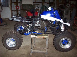

here is mine so far

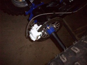

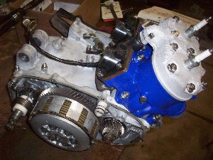

Def cutting the front fenders but I dont know about the rears. I just tore down all the calipers and front master cylinder to have have them powder coated white. The plastics are white as well. Also have the jugs powder coated yamaha blue. All the bushings, seals, and bearings have been replaced from top to bottom. I dont think you can tell from the pic but I also invested in a polished stainless bolt kit. The frame is done in a low gloss wrinkle black finish. Looks better in person. I think there is something wrong with my camera. Looks kinda blury. I will keep the pics posted as I progress in the build. Anybody know of a hq ride here in Michigan?

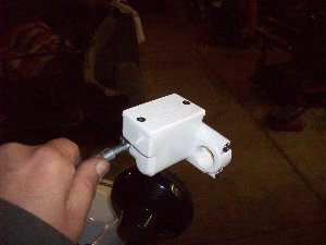

and some more. attn to detail. notice the white calipers and white front master cylinder? No sight glass or casting marks!
the bike looks great how did you get rid of the sight glass on the master cylinder?
Well me and my powder coater thought it was made out of glass. When we pre-baked the parts to boil the brake fluid out of the metal the sight glass melted out. Had to remove the steel ring that the plexi glass was pressed in with the welded up the hole with aluminum. Also had to grind down the aluminum casting marks and the shoulder that the glass was pressed in. Looks sweet!

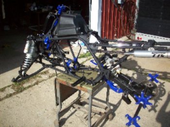

heres where im up to
looks good.........Im almost completely done............will put up more pics soon. Got a roof job to do this week. So I dont knw when I will have time.......... :ermm: :huh::confused:
I like the way those colors pop against that black. Looks nice man.
