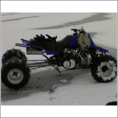

1996dragshee Posted November 7, 2008 Report Posted November 7, 2008 What size marvin should I run in the rear for a +10 swingarm. thanks for your guys help. i run a +10 with mine..really old pic but got my marvin on it Quote
