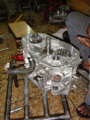

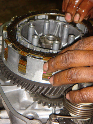

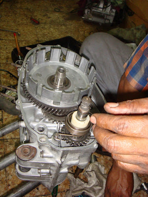

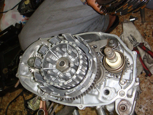

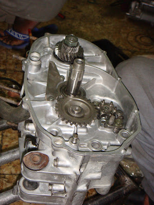

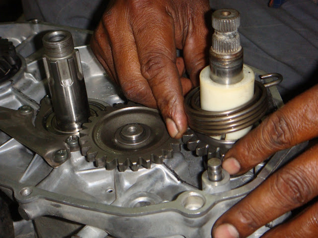

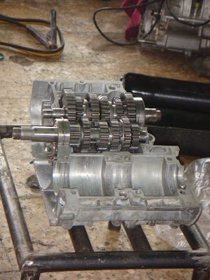

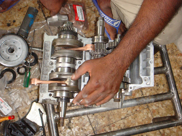

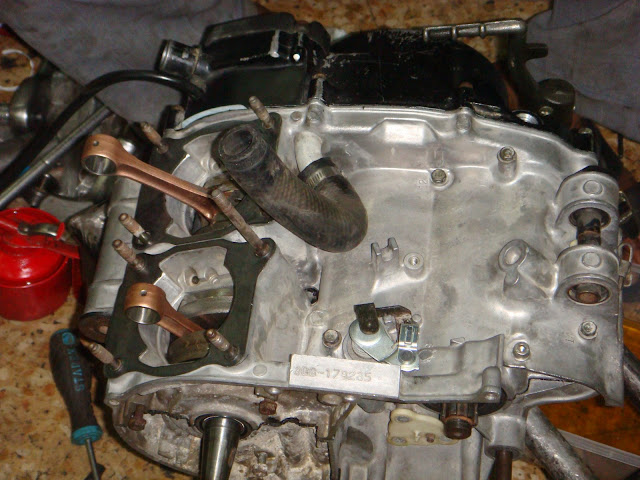

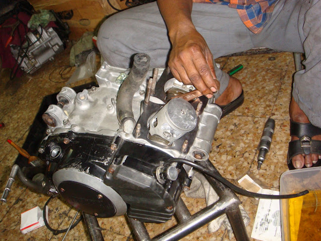

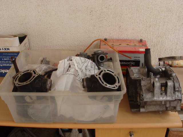

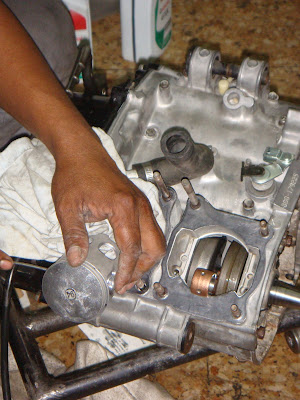

prossett Posted October 6, 2008 Report Posted October 6, 2008 The experts have seen it before, but for the rookies here are some pics of the rebuild - done in the UAE: The shop: The mechanics: The quad: The engine: And this is how it's done - first, clean so I can eat my curry straight out of it. Lower carrier: Upper carrier: Slap in the gears, see if they turn - check neutral: Add the crankshaft: Quote

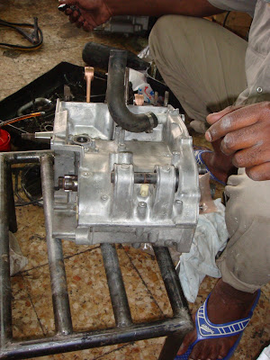

prossett Posted October 6, 2008 Author Report Posted October 6, 2008 Close the casing - guys, this is so easy there is no reason to pay anyone to do this!!!: Quote

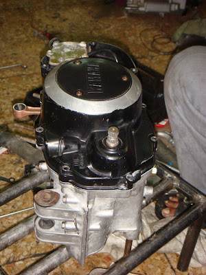

prossett Posted October 6, 2008 Author Report Posted October 6, 2008 Fast-forward, finished product: The dunes waiting for me: Quote

_Hex* Posted October 6, 2008 Report Posted October 6, 2008 dude did you guys just put used pistons on that? why whats the point of the rebuild then? Quote
prossett Posted October 6, 2008 Author Report Posted October 6, 2008 (edited) Yeah, with a few basic tools and following the repair manual, I'd say it's within anyone's reach. I hadn't taken the engine apart myself so I wasn't sure, but looking back it really was pretty simple. New pistons buddy. Instead of Yamabond the guys used a tube of car windscreen gasket. Edited October 6, 2008 by prossett Quote
