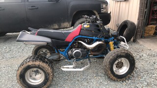

  18. And yes fmf gold series fattys
  19. The numbers on pilot jet are 27.5 and main jet 300
  20. Not sure on jet size, not much experience with carbs, and I’m running k and n open filter straight off the carburetors. I’m at 750ft of elevation and when I say bogs I mean it falls on it’s face, until around top of 4th then runs good.
  21. Just bought a banshee mostly stock except gold series exhaust and TORS delete, starts, idles, and revs good but bogs on low end when you take off and starts running great about top of 4th. Came with an extra set of carbs which I have swapped and it seems to be a little better but still bogging any help would be appreciated for I have always wanted a banshee and finally got one just tryna get it tuned right.
