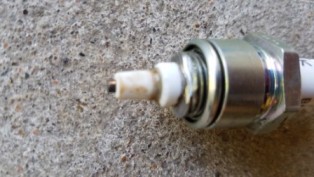

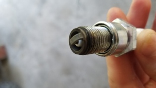

  8. Finally got around to doing a plug chop last weekend after a few modifications that I got from Jeff at FAST. Trying to get the jetting dialed in. What do you all think so far? Engine warmed up on old plugs. New plugs installed and ran WFO for one pass. 2006 SE Temp: 90 degrees Elevation: 1000' St Joe MO Stock carbs Pilot jet: 30 I might bump these down to a 27.5 to crisp up the bottom end a little Main: 310 Needle: stock middle positon A/S: 1.5 turns Carbs synched with carb tool from Jeff Klotz 32:1 50/50 race fuel/91 octane Toomey 2-1 air fliter with outerwear FAST billet adjustable timing +5 Noss/FAST head 21cc domes Fatty pipes for now Vforce4 reeds Compression: 149/147 Stock jugs/bore with no porting In-line temp gauge installed after the head: Runs betwwen 160-170 degrees Serval 421 upcoming this winter
