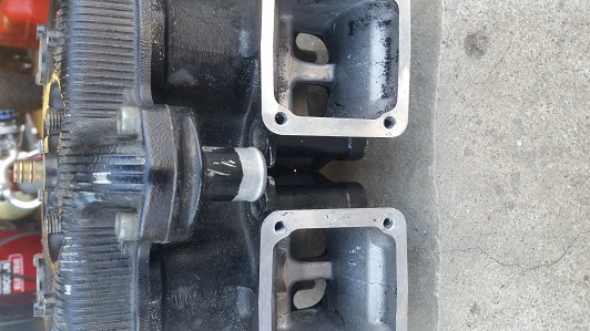

How does this shift shaft look? Im not sure if i can have it cleaned up or have to get a replacement?
