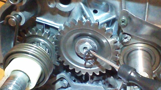

  3. Anyone have any pointers on how to install this circlip? Sorry for horrible picture quality, I had to resize it a bunch of times.
  4. I'm in the same boat right now.... but I bought one that has a bunch of unknown mods done to it and trying to figure it out has sucked donkey balls. I just ordered the circlip (x55) from partzilla.com for $0.77. I've found that bikebandit.com is a great place for a free parts manual, at least to see what the part is you need is called.
  5. Sweet! Will do tomorrow.. thanks Zillafreak
