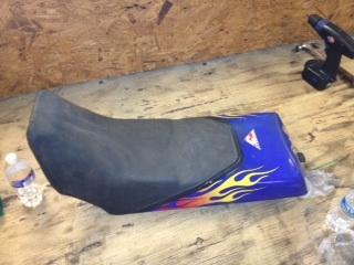

  19. Tryin to get rid of this banshee seat. Only 2 things wrong with it. #1. There is about an inch wide gap in the foam..doesn't really make it any less comfortable in my opinion. #2. It's ugly. Been sittin around and just want to get it out of my way. Lemme know if anyone wants it.
