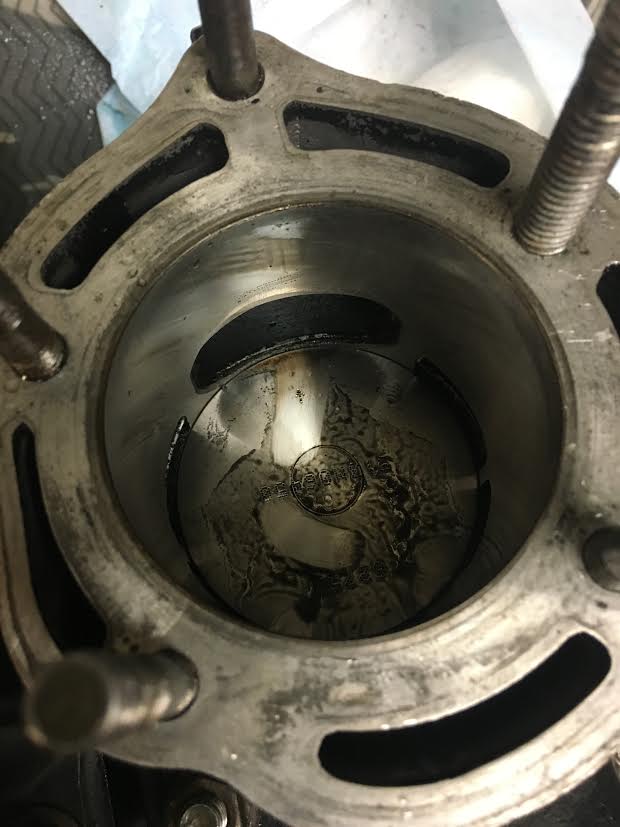

  23. Thats what one of the pistons looked like after I opened it back up to see what was going on.
  24. Update ::: did leak down test and passed.
