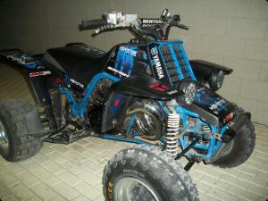

  5. Hey everyone so i got an 06 Banshee never re-built i take very good care of it and in the same time i ride it hard last time i asked to have it checked they said its pretty healthy i've ran a couple of different fuel mixing ratios but i currently run 38:1 and quite satisfied with it. I have toomey t5's v-force reeds, 270 mains dynojets with needle on either 3rd or 4th postion not sure to be honest. I also run a K&N (single) with airbox + lid no snorkel i also have the K&N powerlid i've tried it but it kinda takes away my top end slightly helps low end but not worth it cause you still get this bog sound from the filter (not nice). I have an adjustable timing plate on it thats currently on the stock positon however i am going to mod it +4 degrees or depending on my engine. I was thinking about getting rid of the airbox and installing those K&N pod filters (dual) with outerwears but i'm not sure about the jetting so far according to my feelings and plug color (brownish tan) the 270 is a suitable size with my set-up. The jet kit i got moose racing dynojets came with 270's 280's and 340's so would a 340 be good with the dual pod filters with outerwears? I was also thinking of getting a coolhead i like the pro designs but there kinda pricy i found those 2 from a trusted site i already ordered from. http://www.motorcityatv.com/motor-parts/1987-2006-yamaha-banshee-billet-aluminum-cool-head-new/ http://www.motorcityatv.com/motor-parts/87-06-yamaha-banshee-chrome-plated-cool-head-new/ Do they add power or just help cooling? what about the dome size i think the stock is 22cc i run premium 95 octane fuel so if i change the size ill be okay will a 21cc wont i? I like modding but staying safe in the same time so if its going to harm my bike i don't want it. I run a 15/41 gearing didn't really notice much difference when it was stock 14/41 a friend of mine suggests 15/42. What else can i do Filters? Coolhead? umm what about getting pistons Weisco or something good and reliable that won't decrease engine life or bigger carbs. If pistons are a good idea what size and all i dont know much about them so please help, same goes with carbs. Thanks for all your help guys and i'm not interested in having my stock head milled they say it can cause damage neither porting or any of that crap. According to my Vapor gauge i managed to clock 141.7 km/h (88 mp/h) i know thats fast but its never fast enough! i passed 2 700's with dual DMC power commander and pro-design k&n filter, the 2nd one same mods but different pipes (Big Gun duals) they both clock their bikes around 137 km/h (85 mp/h) and they dont run airbox lids. Didn't try racing other bikes yet. I was also thinking of have my front fenders shaved like the racing style i think it'd look better improve cooling, go faster, but only problem is riding behind other bikes which i do not do much.

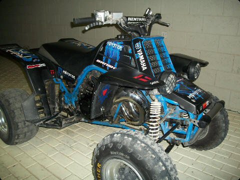

  6. Alright so i have a 270 main w/ 25 pilots needle is set either 3rd or 4th not sure however its the needle that came with my dynojet moose racing jet-kit. I run a k&n airfiler (single) with airbox led no snorkel toomey 5 pipes and as far as I can see its a perfect jetting set-up, the plugs have this nice tan-ish brown color runs great. I was wondering if i get rid of the airbox completely and install the pot k&n's with outerwears what should my main jet size be, 280 & 340 mains came with the kit i bought. According to my Trail Tech Vapor I managed to hit 141.7 km/h (88 mp/h) I am very satisfied but you know what they say very fast isn't fast enough. Toomey T5 V-Force Reeds 3 K&N Air Filer 15/41 Gearing 270 Moose racing dynojet Trail Tech Vapor Renthal Handel bars 2.5" DND rear spacer BANSHEE Bros for life
