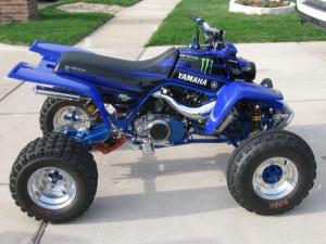

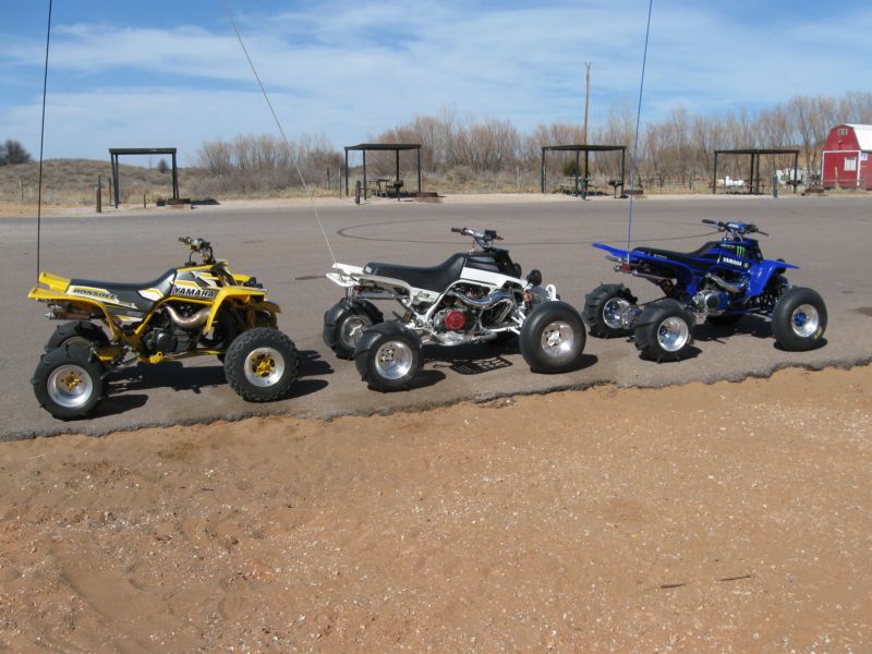

  10. I am fairly new to banshees and the forums and haven't quite got the adding pics down yet... I decided to just add them as a link. Any advice would be greatly appreciated. I had been stocking up on parts for a few months. I decided i was going to knock out all three of my banshee rebuilds in time to take a trip to Little Sahara for spring break 5 weeks away. After a lot of 2am nights and half awake days at work I managed to finish the last one just in time to pack and leave the next morning. I can't say it was fun, but I'm glad I did it now. I did all my own powder coat except the candy blue frame because my gun just didn't have the power to lay on the candy coat evenly. I want to give a special thanks to Custom Powder Coat of Dallas for a quick turn around and an awesome job on the last frame! Here is all three bikes before and after. The yellow bike went back to almost stock and was mainly a donor for parts on the others. I traded my brother a free trip and ride on the yellow bike for some help on the rebuilds. Banshee Rebuilds
