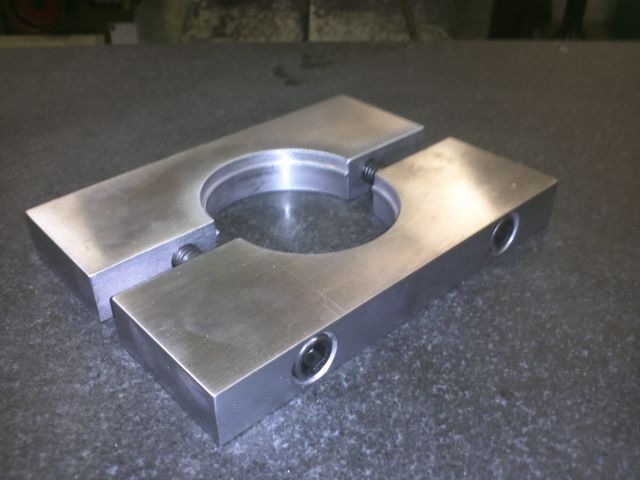

Cam I hear ya! I have done plenty of single cylinder cranks but this is my first banshee crank. I ruined my flange puller like rocky mountain sells trying to get one of mine off. The puller I made pulled it off with no heat like it was nothing! It also doesn't contact the crank! I'm going to make a few fixtures as I go through this crank and will keep you updated with some pics and vids if I can. I see a lot of info on this site but nothing on cranks? So I'll share the info on my rebuild as best I can. More to come.

What puller do you use? I had trouble with the flat flange one I had because it couldn't get under the bearing enough and bent the tabs trying to get on of the bearings off. I have a press and have definitely put a few things in the oven and or freezer to get them apart. Any other alignment fixtures or tools used? I am making a fixture to keep everything in phase and to get the press height right. Also have some gauge blocks and indicators to check phasing. Just curious what tools anyone else uses?

So I decided to rebuild my own crank and had hell getting the outer main bearings off! Ended up machining a new tool to help. Going back together with hot rods connecting rods and NTN 10 ball max load bearings on all 4. What does everyone else use? Photo Album

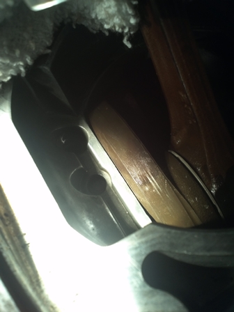

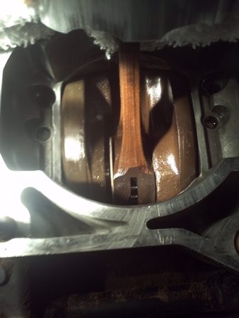

Hey thanks for the offer okbeast! Nice to know your close by. I also met TNTS355 on here too. Yeah I definitely used a rag! Made that mistake a long time ago and never again! So I finished the tear down and unfortunately it wasn't the wrist pin bearings! I pulled the cylinders off to find the wrist pin bearings had no play and the rod main bearings are horrible! I took some video and pics of it all, and will try to post them tomorrow. Problems found: 1. Left side of the crank looks as if it wasn't pressed correctly. Maybe its just me but the left rod prolly has .100"+ of side slop, and almost zero clearance between the left side of the crank and case. The right side rod prolly has .050" and the crank looks centered in the case with equal clearance around it. 2. With the rods pressed over solid to one side there is a considerable amount of twist and rock in the bearings. I think with a stock crank and cylinders punched .080 over I'm going to clean everything and button it up with new gaskets for now. I'll run the dog shit out of it for a while as is and save for a full kit. Something like a 4mil. Any suggestions on what to plan for? I dont want full on drag but something capable of being fast trail or dune ridden but still go drag for fun occasionally. I owned a 421 long rod with ported stock jugs and high comp. years ago and loved it! Cheetah, Cub, Serval? Which one and why? No problem running 110 octane all the time also... running T5 pipes and stock carbs now. -
