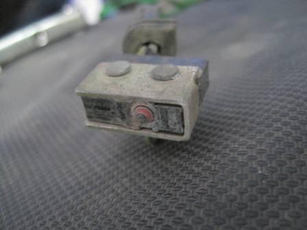

  5. I was Looking to find why my kill switch wouldnt work somtimes i figured it was a bad ground because the previous owner painted the frame well i came a cross this on the right front by the radiator it was pluged in and the little round thing is like a pressure with or somthing it clicks when you push it in. i was just wonder what this was and if its important .
