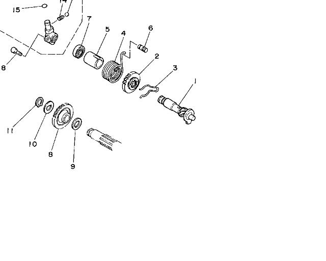

also, in the picture at the top of the post. what is item #6? it is labeled a stop, but I don't remember seeing it when I had the clutch cover off. I don't see it on any pictures on ebay of the assembly either. -

How much play should there be if any in the kick gear and kick idle gear? In the attachment, the gears are #2 and #8. I had a rattle at idle and was trying to find what it may be. It doesn't happen all the time. I already checked the flywheel and everything appears to be tight on that side. I have pulled the clutch side cover off and noticed both of these gears have play. Thanks.
