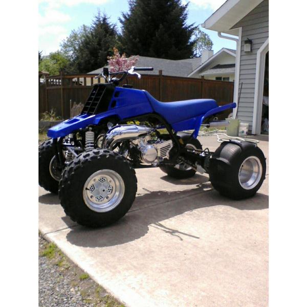

So today i finally rode my 421 cheetah cub for the first time, I noticed every once in awhile alittle fuel would come out on one side, out the overflow, When i put my jets in last night i kinda looked at the float but didnt really look at a way to adjust it....So how do you on a 38mm keihin carb? and where do i measure and whats the right height? Does anyone have any detailed pics? im at work now..... I thought jetting would be a bitch but it was actually really easy got it pretty close first time, is there that much of a difference when you change the mains between acouple sizes? it starts pretty much first kick, just wondering if i should even mess with it...but i want to stay on the safe side, plugs look good nice light brown....

Have everything but the carbs left on my build which im gonna buy next week, i just bought a jet kit off ebay with mains, 180-200 and pilots 15-60.....gonna go with either 38 or 39mm pwks next week. Think the mains are going to be to rich for me? do i need to buy some in the 170s? thanks... CPI's inframe 4mm cheetah cub dune ported...421cc trinity stage IV head...going to run on 110 octane. v2's 8" k&ns sea level to 1500ft 65-80 degrees
