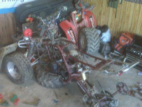

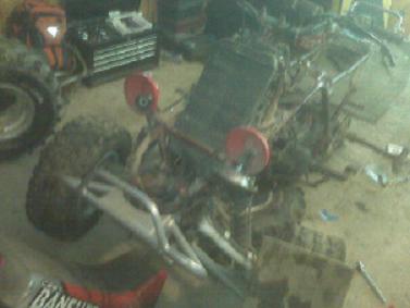

ok i feel like a big and i mean big dumbass. what i have found out is the crack isnt a crack after all. its just burs from the actul cast molding itself. but i did get 2 pics of the shee tho so everyone can see what my 400 dollar project looks like.
