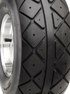

    tires
    thats what i thought but it says they are for dirt flat track
  2. groutman
    tires
    would these be any good as i only drag this banshee
  3. groutman
    tires
    i just won a set of duro tires and i can pick wich ones i want any suggestions that would be good for dirt drags
