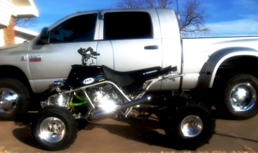

Here's my 2002 shee I give 2300 for this bike, it was bone stock when I got it.4 mill cub cylinders,4 mill stroker crank,lockup clutch,barnett basket,cpi smallbore out of frame drag pipes,cool head pro d,8 over swinger,35mm pwk airstriker carbs,v-force 3 reeds,boss billet spacers,black maire skins,fly handle bars,polished clutch and stator cover.ya this is my baby!
