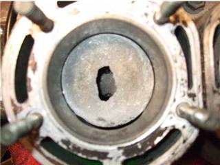

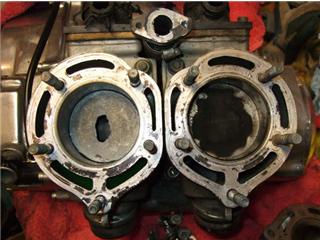

Hey a couple things. First of all, I'll attempt to upload some pics of the carnage...and it is truly carnage. Can anyone tell me about the side without a hole in it...the entire top of the piston is black. Is that normal? Everything was done to this quad when I bought it in August of 06. The guy had every peice of paper for everything that was done to it...which is where I got the info. The head was reportedly shaved .60??? whatever that means. It ran so F'ing strong. I only ever go to the Oregon Dunes (Florence, Winchester Bay) so at sea level. Jetting...sorry to say I don't know. The plug checks always looked stellar on both sides...so I never worried about it. Guess I need to gain an understanding about how often to do the top end...after how many hours. Can anyone give me advice on that? Debating on sending the motor to FAST to have Jeff go through it. Going to do some simple upgrades...V-Force 3's, Cool head, timing plate...nothing radical. I'd do the work myself but not sure what this kind of failure means. The crank was "tured and welded" whatever that means...so is it damaged? How can I tell? I can see chunks of the piston down in the motor. How do I get those out? Can I without splitting the cases? Too many questions, I know. I'm going to talk to give Jeff a call later in the week, when he's not so busy, to discuss all this. So don't feel obligated to answer...but I haven't seen answers to those quesitons in the forums yet...(and I actually looked a little.) Anyway, enjoy the pictures (if they worked). The only good part is that I destroyed my buddy on his brand new Raptor 700...like it wasn't even there. It was a good feeling...until it went boom. -
