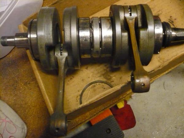

So - What cause the lean condition - that's a good question. I'd like to bounce this off you all. A guy I trust at a shop in Oregon took one look at my piston and was able to tell me exactly what I was doing when it blew. He said, "oh, interesting - found the flats did ya, I hope you won." Huh, I replied. He then said, "yeah, you can't do that. Banshees like the hills. If you're going to drag race, hit the top and let off. Don't keep running or you'll lean it out - sometimes as much as two jet sizes." Well, that's exactly what I did. I was drag racing on the flats, and basically kept it open for a while after I hit the top of top. I'd back off for a second at a time, but then I'd get back into it. I guess that's a bad thing. Does this track with what you all know? or should I look for addtional causes of the leaning? -

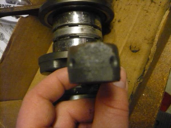

hey Everybody...thanks for the info. Feeling much better about things after reading all these posts. Lots to consider. I was being a whinny little bitch when I wrote this last night. thanks for setting me straight. You all usually have lots of common sense advise. We'll see how it goes. going to try and clean it up. Wrist pin looked fine. When I say the Rod was scored, I mean that the top of it is rough...like metal has either been welded to it, or scraped from it...not sure which. the rod bearing...hole?...is perfect...not deformed at all. I'd just hate to spend that money and not be sure. I'll let you know what I decide to do. Thanks again. -

Yeah...I guess I needed to hear that. I think you guys are right...dammit. Thanks for the honesty. Nobody ever talks about what money pits these things can be. $1,300 for the port work and all the upgraded parts (labor, V-force 3 Reeds, cool head, domes, bearing kits, gasket kits, etc...etc...) $200.00 for new chain and air filters and rear sprocket. $640.00 for New CPI's $500.00 (give or take) for the crank shaft $2,640 by my math - and no Cub kit! Bought it for $3,850.00. I believe this is what you call - upside down - equity wise. Sorry for the negativity. -

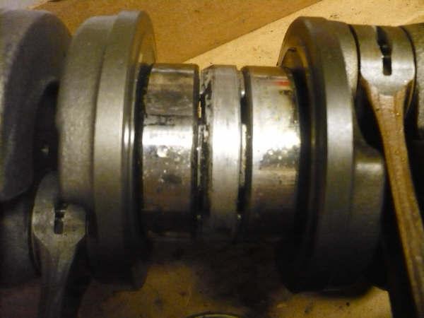

I leaned out and blew a hole in my piston. Just split the cases last night, and the crank shaft is discolored. It obviously got really hot. The top of the rod is scored. there are metal shavings EVERYWHERE! A guy I trust said the center bearings can be flushed out with mixed gas. Should I trust him? Has anyone ever done that? Do I need a new crank shaft, or is the dis-coloration a minor deal? It was a trued and welded crank. I'll be running a Cool head with 19cc domes, an extreme port job with advanced timing, k&N Pods, and CPI inframes. Please tell me I don't have to spend another $500.00 on a crank shaft...that I can just rinse it out and it'll be ok. Thanks.

OK...will do. One follow up question: I agree on the lean part...not much doubt. But how? Air leak? What did you mean by air leak? The jetting's always been money. It was due for a top end for sure, but what would cause it to lean so suddenly? -
