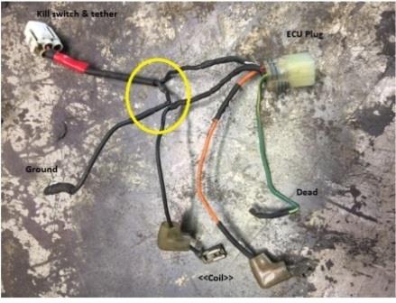

  16. I'll take em. PM me your PayPal info. Thanks

  20. Ok. Still trying to figure it out. Used a test light on both switches and light goes on when pushing in the button or unhooking the teather. So I assume that's normally closed? How's the oem key set up? How would that ground off the coil impact that?? Thanks
  21. Here's my shut off set up. I'll have to test them. However, I did unplug them and jump with a wire and it still wouldn't start?/ http://www.bansheehq.com/forums/index.php?/gallery/image/8771-switches/
  22. Just took another look at the wiring diagram and the only thing that is grounded is the voltage regulator. Since I'm not running one as I don't have any lights, is that OK?
