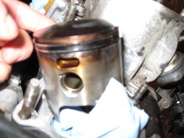

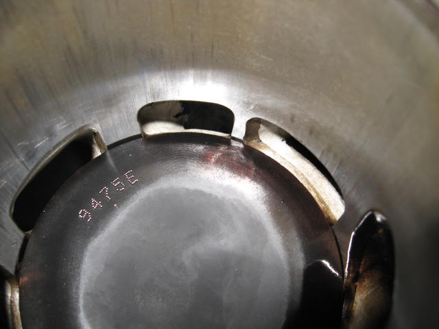

I took my head off and heres a pic, when the pistons at BDC the crown of it is still a couple mm higher than the bottom of the ports..
Is this a reason for my all the blow by im getting as shown in the other post, and can this cause a lack of power?
