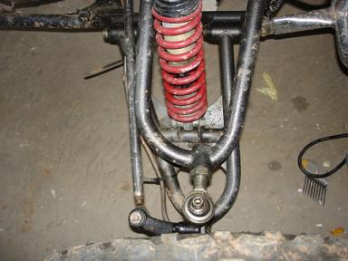

Fireroad Express Posted June 8, 2008 Report Posted June 8, 2008 (edited) heres a pic of my ASR +3+1 s . the upper looks backwards and may very well be, but i had clearance probs with the shocks when the uppers were switched. be nice if they sent instructions with these.hopefully thier customer service improves. so far these are a good set of A-arms and have had no probs with them. i lube the heim joints and mounts after every run. Edited June 8, 2008 by the grinch Quote
Meat Posted June 10, 2008 Report Posted June 10, 2008 I dunno Grinchy, first thing I thought when I seen your picture is "that dont look right " But its hard to really say if its right or wrong without seeing pictures of it mounted the other way. It looks like if you'd flip your upper A-arm around, it would match the angles of the lower A-arm. I think you'd want both arms parrallel to each other. I dunno man, its a hard call. This ain't the first time this question popped up BTW. It seems that a simple set of directions from these A-arm companies would help alot of people. Quote
peterlocal22 Posted June 10, 2008 Report Posted June 10, 2008 If you flip them around they would be -1 +3 not +1+3. Quote
fastrthnu Posted June 10, 2008 Report Posted June 10, 2008 dunno if it helps, but I already had them on hand. Quote
peterlocal22 Posted June 10, 2008 Report Posted June 10, 2008 ya, curve on the back that correct but its different for other a arms. mine are like the grinch's and fasterthnu however asr are not all the same it depends on the year of the purchase i think.. im pretty sure they get there stuf from eyeball racing right? Quote
