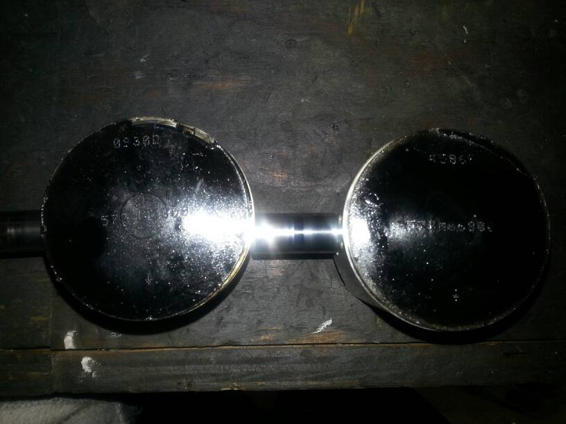

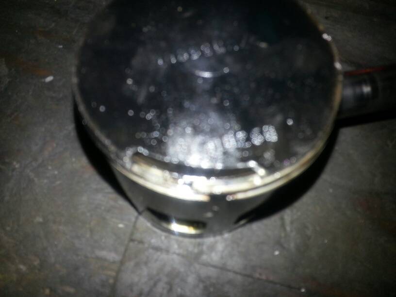

SpeedRacer88 Posted December 13, 2012 Report Posted December 13, 2012 Both pistons intake side Sent from my Galaxy S3 using Tapatalk 2 Quote
SpeedRacer88 Posted December 13, 2012 Author Report Posted December 13, 2012 Trail tech always stayed under 165 pistons show really rich Sent from my Galaxy S3 using Tapatalk 2 Quote
SpeedRacer88 Posted December 13, 2012 Author Report Posted December 13, 2012 Top end is like 3 months old leak down was good timing is at 4 its a serval 165 psi running av gas Sent from my Galaxy S3 using Tapatalk 2 Quote
sprinklerman Posted December 13, 2012 Report Posted December 13, 2012 That piston is not showing rich. At least according to the info ive seen, you should see some piston wash across the top. not solid black like that. Looks lean to me. Quote
SpeedRacer88 Posted December 13, 2012 Author Report Posted December 13, 2012 So these are lean? Sent from my Galaxy S3 using Tapatalk 2 Quote
special06shee Posted December 13, 2012 Report Posted December 13, 2012 My buddy had a cub that did the same exact thing! Top ring flange broke clean off! Still ran great, and had same compression in both sides! We just chalked it up as a bad piston.. Jetting was spot on and had very little timing in it. Only reason we noticed it was we were changing out the domes! Quote
sprinklerman Posted December 13, 2012 Report Posted December 13, 2012 So these are lean? Sent from my Galaxy S3 using Tapatalk 2 yep. Do some research on reading piston wash. Quote
AKheathen Posted December 13, 2012 Report Posted December 13, 2012 that's classic example of "sucked a ring land" usually from deto. likely got cold and either the jetting wasn't comphenasted, or the oil was separating. Quote
SpeedRacer88 Posted December 13, 2012 Author Report Posted December 13, 2012 That sounds more like it it was really cold around d here recently I just wanted to make sure it wasn't sumtin I was doing wrong Sent from my Galaxy S3 using Tapatalk 2 Quote
sprinklerman Posted December 13, 2012 Report Posted December 13, 2012 That sounds more like it it was really cold around d here recently I just wanted to make sure it wasn't sumtin I was doing wrong Sent from my Galaxy S3 using Tapatalk 2 you did do something wrong. haha. He's saying if it got cold you should have upped your jetting and ran it lean. then heat/and or deto set in....your mistake. Also possible that the oil had separated . But im betting on lean/and or deto. the reason im saying its prolly not oil separation,is because it hasn't been that cold in your area BTW. not saying its not possible,just not too likely unless temps are down to 32* for awhile ..depending on oil of course. Quote
SpeedRacer88 Posted December 13, 2012 Author Report Posted December 13, 2012 Yeah at the exhaust is what I'm use to seeing these started at the intake Sent from my Galaxy S3 using Tapatalk 2 Quote
SpeedRacer88 Posted December 15, 2012 Author Report Posted December 15, 2012 quick queston I'm at around 165psi compression .048 squish freind of mine blew is bike up and had about 7 gallons of 93 mixed he let me use... Would this cause this? it was weeks ago. also is this more of a lean problem or could it just be from deto.. i know i sound stupid i'm not... jus cheap Quote
