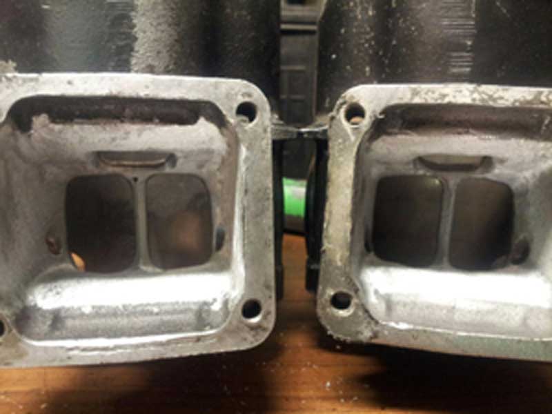

463duner Posted June 1, 2012 Report Posted June 1, 2012 I'm looking for either a stocker thats milled .030 or a aftermarket with 20cc domes. I'm aiming for 170 psi with exhaust blocked. Setting up for pump gas and trail riding Here the pics. Let me know. Thanks Quote
turbowrenchhead Posted June 5, 2012 Author Report Posted June 5, 2012 So what would this put me at for compression? Are these milled .030 inches then? Here the pics. Let me know. Thanks Quote
nastyracing Posted June 5, 2012 Report Posted June 5, 2012 35$ shipped i have a stock head milled .020 pics were in my fs add i will dig them up pm me if you serious Quote
463duner Posted June 6, 2012 Report Posted June 6, 2012 So what would this put me at for compression? Are these milled .030 inches then? Yes these are milled 30 thou. Compression is determined by altitude. i ran these on pump gas at approx 1500 ft with no problems. Can't remember the compression at that level but ran great. Quote
nastyracing Posted June 6, 2012 Report Posted June 6, 2012 the middle head in pic is shaved .020 and will be able to run pump fuel with added compression and not worried about to much compression and have to run race fuel Quote
