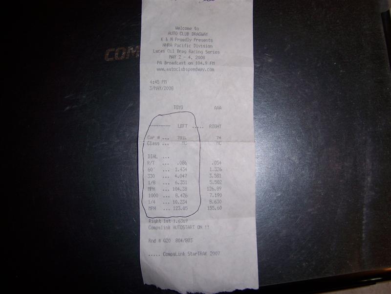

SlowerThanYou Posted August 8, 2011 Report Posted August 8, 2011 Here's an old slip accomplished with 230 lb. rider, stock frame (335 lbs), 443cc cub on race gas and no power adder. Quote

J-Madd Posted September 15, 2011 Report Posted September 15, 2011 We use the same ratio for both 1/4 & 1/8 mile. Things have to be done differently, but our best 1/8 mile times have come with the 1/4 mile gearing! I noticed that on your time slip, and thought that was odd. That's a good 1/8th mile time, yet its geared to run 120 mph. What gear are you in at the 8th mile mark?? I was asking the OP what timing, but if you want to give yours that would be great. I don't run asphalt, but would think that it would need to be a few degrees lower than what we run on dirt in 300 ft. Quote
SlowerThanYou Posted September 16, 2011 Report Posted September 16, 2011 I noticed that on your time slip, and thought that was odd. That's a good 1/8th mile time, yet its geared to run 120 mph. What gear are you in at the 8th mile mark?? I was asking the OP what timing, but if you want to give yours that would be great. I don't run asphalt, but would think that it would need to be a few degrees lower than what we run on dirt in 300 ft. We have been faster than that in both 1/8 & 1/4, using the same gearing. On that run we were in 6th gear 100'-150' before the 1/8 mile. Quote
