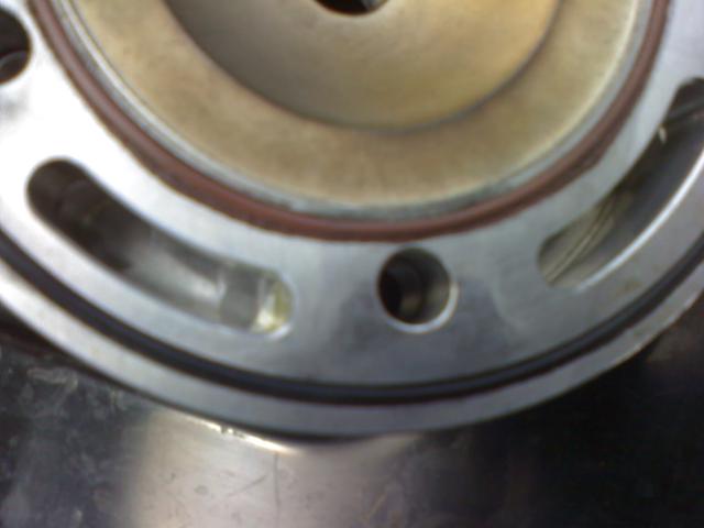

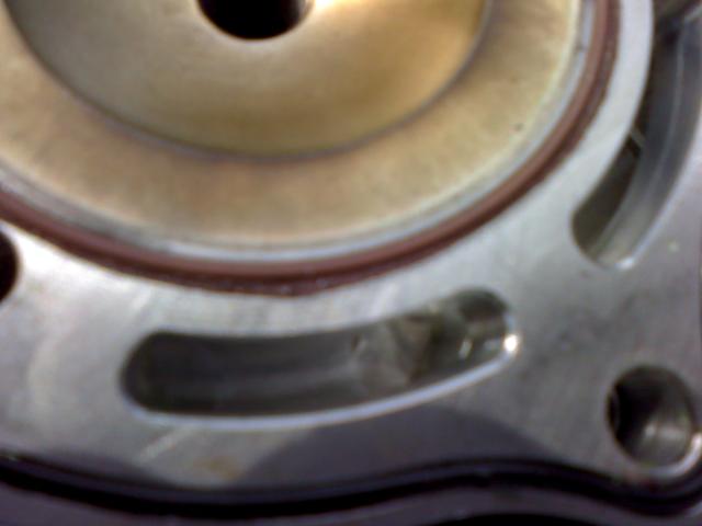

Nutwood 472 Posted April 12, 2011 Report Posted April 12, 2011 hello,built serval,my mods are 22cc cub domes,noss cool head, shearer sb in frames 160 comp,420 elevation,35pwk air strykers 52 pilot,165 mains,cgl needle middle clip,6 inch pods,br8es ngks,DYNA programable cdi,cdi programed for 3 degrees on stock curve ,DYNA high out put coil,rs stator on zero degree on timing plate,in line 3 inch cooler,pro design over sized radiator,pro design high flow water pump,billet intakes with built in cross over, running 92 pump gas with klots super techplat 20%castor 32:1 ratio,did compression test when we got back to the shop,right side was 160 and left side was 30 psi,took exhaust off and carbs and did leak down test and held for over 20 mins,then drained coolant and took head off and cylinders,orings in the domes looked funny,never seen orings look this way,ive had this shit happen to three other new builds,so M&M said to lose the junk dyna cdi and go back to a stock one,they think the cdi is advancing the timing curve on the top end rev and detination is the results,all pics are in the gallery of the domes and pistons,if i dont get to list them all in the post,like to show everybody and get some views,thanks for all the opinions guys much appericated Quote

BUILDER Posted April 12, 2011 Report Posted April 12, 2011 I have never ran the dyna ignition but I know lots of guys that do and they have had good luck with them. From the pictures that thing looks like it was just lean to me but hard to tell from the pictures. That sucks on a new motor man! Quote
RadarRacing Posted April 12, 2011 Report Posted April 12, 2011 Any pics of the piston crown, underside of the piston or is there any pitting at all on the piston or dome? Any damage or funny coloring on the plug? I would have thought your jetting was in a fairly safe range. I'm with Andy and the stock ignition. Quote
Nutwood 472 Posted April 12, 2011 Author Report Posted April 12, 2011 Any pics of the piston crown, underside of the piston or is there any pitting at all on the piston or dome? Any damage or funny coloring on the plug? I would have thought your jetting was in a fairly safe range. I'm with Andy and the stock ignition. there are pics in gallery of pistons,no pitting in domes,but domes have a light green tint and so do the pugs on the metal tab,both plugs and the porcian was white,no pics of under side,just sent everything to Andy today,going to put stock cdi back on and now im looking for a good used stator for a 1995,thats the year of my bike.The orings were flaten and melted looking around both domes,I have been thruogh this problem breaking pistons on a 472 t-rex,sold it,bought super cub,broke pistons again,twice on each build,traded the super cub on a serval,and guess what,it happened again,and the only thing that wasnt changed on each build,The dyna CDI and the ricky stator,tested stator and tested good on all circutes,but Andy said that doesnt mean nothing,rs stators are known to jump timing at high rpms,so I'll give it a try,everything else is new,from carbs to exhuast,lol when it climbs into the high rpms,it seems to take off like a turbo and screams and dont stops,even with 190 mains and 52 pilots and there is no air leak to be found,i run a daul pingual and 5/16 or 3/8 fuel line and the tank cap is drilled out,so just dont know,im just tried of chaseing this problem,ive bought enough pistons to build another engine,lmao all i can do is keep my head up and hope this will fix the problem,and Andy cant belive i have 160 comp with 22cc domes,so he's cutting some different domes for me,He's a hell of guy and a excellent sponsor to,I would refer M&M to anyone who wants to go fast,lol Quote

camatv Posted April 13, 2011 Report Posted April 13, 2011 if its a "cold sieze" then you know what happend ( wayy to much rpm before it warmed up) most cast alluminum cylinders are not as prone to cold siezure due to the pistons and cly warming up at the same time almost looks like lack of oil or lube or a lean out. you can usually hear deto when its doing it. those domes look a lil more than a 22cc might want to check that out also. the marks on the o-rings are from installation they squished out on the top of the cyl and the head they most of the time wont do that if you grease them well so they kinda slip around when you are installing them. but more often than not they kinda do that anyways. Quote
Nutwood 472 Posted April 14, 2011 Author Report Posted April 14, 2011 if its a "cold sieze" then you know what happend ( wayy to much rpm before it warmed up) most cast alluminum cylinders are not as prone to cold siezure due to the pistons and cly warming up at the same time almost looks like lack of oil or lube or a lean out. you can usually hear deto when its doing it. those domes look a lil more than a 22cc might want to check that out also. the marks on the o-rings are from installation they squished out on the top of the cyl and the head they most of the time wont do that if you grease them well so they kinda slip around when you are installing them. but more often than not they kinda do that anyways. Yes cam,a true cold sieze is from not letting the cylinders heat up with the piston and so on,but the engine was warmed up to operating range and had been riding half the day,and the domes M&M cut for the serval and the o-rings for the domes had some engine rebuild lube on them to keep them in the domes for installation and if they were leaking,i would of notice when i checked for that,before i installed the exhuast,i'm really a nit picking bastard when putting these engines together,I've had this same problem on a 472 t-rex,a 472 supercub,twice on both builds and now this one and the only thing on all the builds that has not been changed is the dyna cdi & ricky stator,M&M programed it twice,once for the super cub and once on the serval,on every build,i was breaking pistons,and i can put 190 mains in and it would scream on the top like a freaking turbo and with no air leaks,so they are thinking the CDI is advancing the timing to much at the top of timing curve,but i dont program cdi's,so i dont know,and i never seen the o-rings on the domes ever push out and melted around the edges,pics suck,because they are from my cell phone,they were like that on both domes,just not one,so hope fully we get this figured out,lol but thanks for the input cam Quote
