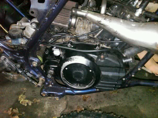

just got a bike that has lrd pipes on it but no mid pipes or silencers, looking to see what i can possibly do..... im thinking im gunna have to fab up my own. would stock work or should i get aftermarket ones and hack them up? as for motor mods idk whats done to it i got it for $500 so i dont think alot. he said "new top and bottom end" but idk, k&n's and pipes are the only mods i know of.

im on both thos sites everyday looking for lrd silencers but no one has them.... and i dont have any friends that have a banshee so i cant even try to fit a diff set . and i do have the tools not so much the know how but im pretty smart with that stuff. i do have a v8 in a luv......

well, toomy silencers usually run pretty well on other pipes. cascade silencers are made for putting on whatever, but you might have the most luck with fmf silencers. they have the larger diameter stinger tubing, are the longer of the 2 common connection points, and are made with steel stinger tubes for easier modification.... there is also several different styles to choose from on the silencer it self.
so, i'm sick in bed with little to do today......and i was looking through the f/s section on here and found you some that i believe might just work great, or even be the exact ones you need....
http://bansheehq.com/forums/index.php?showtopic=136332
i did as much research as i could, and i know the new lrd's use silencers that resemble fmf's, but i think they are the only inframe that uses an added mount close to the header.......i'm not certain on that, but it would make since to need them, since they had one-piece headers, and adjustable headers, and that the adjustable ones would need the extra support to keep them square.... i'd definitely give them a shot...
