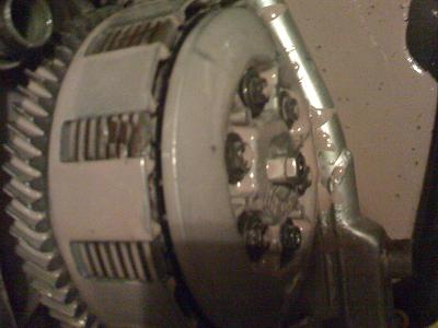

hollisatp Posted February 2, 2009 Author Report Posted February 2, 2009 here is the color.. it was red to start! Quote

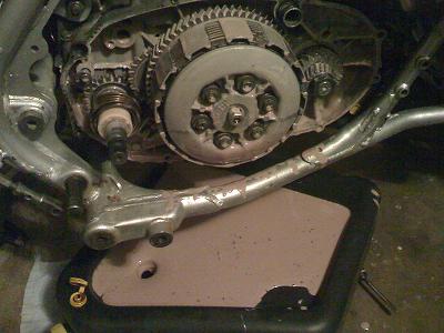

hollisatp Posted February 2, 2009 Author Report Posted February 2, 2009 here is a shot of the groves... might not be able to tell, but they look ok to me..??? Quote
Pyrojunky619 Posted February 2, 2009 Report Posted February 2, 2009 strawberry milk shake! haha, yeah your getting coolant in somewhere. Quote
fastbanshee8 Posted February 2, 2009 Report Posted February 2, 2009 It's definately time for a new clutch, because anti-freeze doesn't play well with the clutch fibers. Might as well throw a pancake bearing in while you're at it. It's good, cheap insurance, to prevent the ball from welding to the clutch rod. Quote
