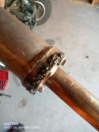

  2. So, I picked up a banshee at storage auction. It's missing random bits and pieces. I'm trying to figure out the best thing to do with the exhaust. I have the expansion chamber, mid pipe and silencer/spark arrester(hope that's the correct part names). however, I'm missing the connecting hardware between the three. I found the clamps that go between the Expansion chamber and mid pipe. What goes between the mid pipe and silencer? Someone tried to weld the two pieces together, as shown in the photo below(I knocked all the shit weld off and cleaned it up with a Dremel tool). Can I simply squirt some RTV high temp between the two and use the correct fasteners? Do I need a special gasket? Should I just pony up the dough for the FMF mid pipe and silencer? A little help for a noob is appreciated. Thanks my dudes and dude'ets
  3. What do you guys think? I knocked off all the shit weld. leaned up the surface on both sides and pressed the flange flat. I got the correct hardware. Just shoot a bead of High Temp RTV and bolt it up? Edit: Happy Halloween Fags.

  5. Hey, It's all good! Cycled the pistons while looking in the exhaust ports. NO VISUAL DAMAGE! SMOOTH! I didn't have any two stroke, so I did the right thing and sprayed out the cylinder w/ dub 40 first and then dumped some 90-75w gear oil down the shoot. Wet compression test yielded 170+ psi. in both holes. Nice! I need some help with various garbage I found. Start with this, I looks like someone tried to weld up a gap here between the mid pipe and the can. WTF? Here is a pic of the expansion chambers, mid pipe and can. I think all I need is to clean all the shit weld up and buy the proper can for the mid pipe. Please advise! Next Item, I have two black wires(one with a white stripe) that have been cut from the pack here. Final item, where can I find a good set of rear knobby tires? I think a rim and tire combo would be the best. It's street, hard dirt here in baja, unless your partying the beach.
