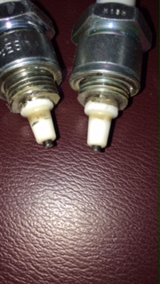

  1. I did a plug chop WOT holding 3rd gear for 10 seconds. With load on the engine via the brake Mind you it is 70* here going into fall
  2. WOT Plug chop 70* outSide
