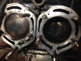

Yeah it all makes sense, I installed the 22cc domes , all went well, Thanks tricked carbine ! I am putting it back together tomorrow and doin a compression test and then hopefully start on the jetting process, also noticed the gaskets on reed valve were splitting so it was probably sucking air there as well , so I bought them today and will replace! -

No pitting that I can see. Just burnt blackish residue. Should I clean that off, if so with what. -
Recently purchased a banshee a few weeks ago, and from advice from folks on here I've been going over everything making sure its 100%. The compression was showing 175 and 170 with a cool head. From what I was told it was due to the domes that were in it. I purchased 22cc domes to get the compression down to run pump fuel. I have only started it up with the fuel that was in it, and rode it up my lane and back. It runs great, starts first kick. I just pulled the head off to swap the domes and found the top of each piston to be blackish brown burnt marks that do scrap off with your finger. The sides of the pistons through exhaust port look fine with no visible scarring, and same for the cylinder walls, from what I can see. My question is was this caused by previous owner running pump fuel with such high compression and can I clean the tops of the cylinders with something? and is this something that I should be worried about after doing the 22cc domes swap. It had 20cc domes in it currently. 2001 banshee FMF Fatty pipes, power core 2 silencers V force reed valve Pro design 2 into 1 foam filter PD coolhead TORS eliminated Keihin carbs
