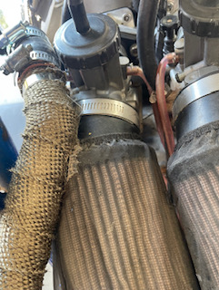

  10. The bike is still with him, he said it might take a while to get it figured out so im thinking maybe a month or 2. He assembled the motor in the bike, I will check to make sure the stingers arn't backwards when I get it back. He did put some spacer on one of the front exhaust hangers so that the pipe would clear the top of the cool head, maybe the spacers are bending that part in a weird angle? If I can't get the pipe to clear I'll order some Cascade exhaust heat wraps to see if it will keep it from melting the filters again. I don't know anything about motor building but I will ask my regular mechanic they know how to do the UCCR test. When I picked up my bike last time he said the 32 domes are 12.5 to 1 compression. I think I will be able to manage the squish test. I already spent a bunch of money with him building this motor, I'm hoping he can get it figured out so I won't have to spend more sending it out, but I might have to at the end of the day.
  11. Yeah he said he ran it. I dropped it back off to him yesterday morning he said he was going to look into it but may take a while to get it figured out. Ill look into the UCCR and squish test if it is still not running right when I get it back. On a side note, do you guys have any suggestion on how I can get my intake to clear the exhaust. I tried putting header wrap on the exhaust to prevent it from melting but that didn't work as planned.
