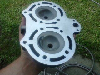

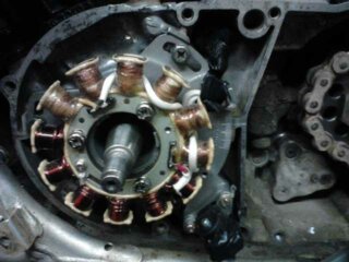

  1. i ride track and trails and i had head milled .020 (research this) and stator plate on +4 and i cant explain the difference it made and stator plate is 35 bones and i got my head milled for free brother works at machine shop

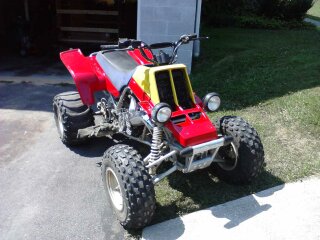

  2. well its been a while but banshee is fixed new stator (china one from ebay lol) and adjustible stator plate set on +4 cylinders i removed casting flaws and put a slight chamfer on the ports for a little better flow and after a seriously long math equation and measuring with calipers i found a drill bit and drilled my stock jets to a 250 main equivelent and i changed her look to the 1988 color scheme (to match my seat haha) i <3 krylon fusion this stator has been surprising me im learning how to rewind them and starting to under stand them better and by my little knowledge its worked perfect and seems well made

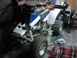

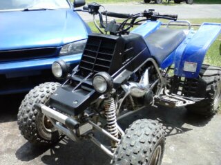

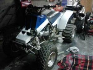

  3. thanks everybody it was blue but it has stress marks and my heat gun couldnt get them completely out but heres more pics i had on phone lol < head milled and cleaned this made a huge difference i reccomend doing this haha < plastidip fun lol (peels off if you dont like it)
