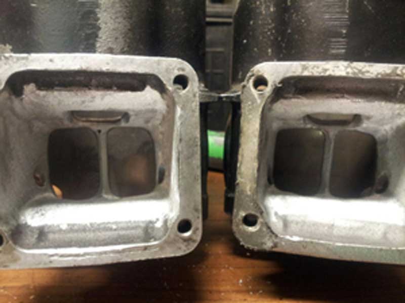

  13. I'm an auto tech of 19 years. I have done several port and polishes on cars. This is my first port on a 2 stroke. After all the reading and pics on the internet I didn't think it would be that hard. I already have all the carbide bits to do it. This pic is the rough cut. I have to go back through and polish it yet with a dremel. Thanks for the input on the jets. I'm kinda shocked that you still use the stock needle on the middle position. I thought for sure you would have to go a few sizes rich to match it up. I had to go through 4 needles on my blaster before I found the sweet spot. Thanks again on the input!
